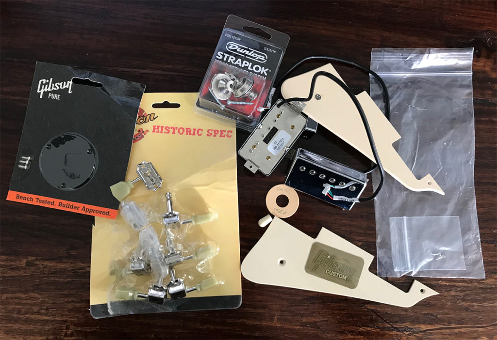

    I have also some spare stuff from my previous LP mods:
    [​IMG]
    As you can see on the above picture, I have two brand new '57 PU that were on my SG. As they are Quick Connect equipped, I plan to use a Quick Connect Gibson Standard board with the 4 CTS push-pull pots.

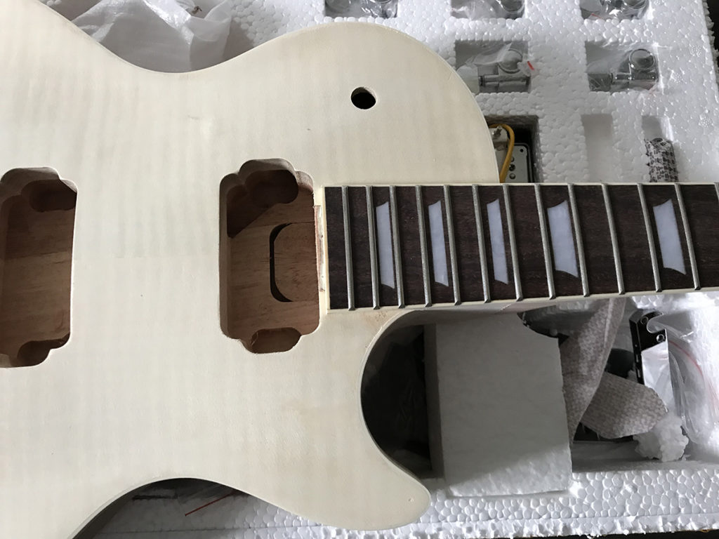

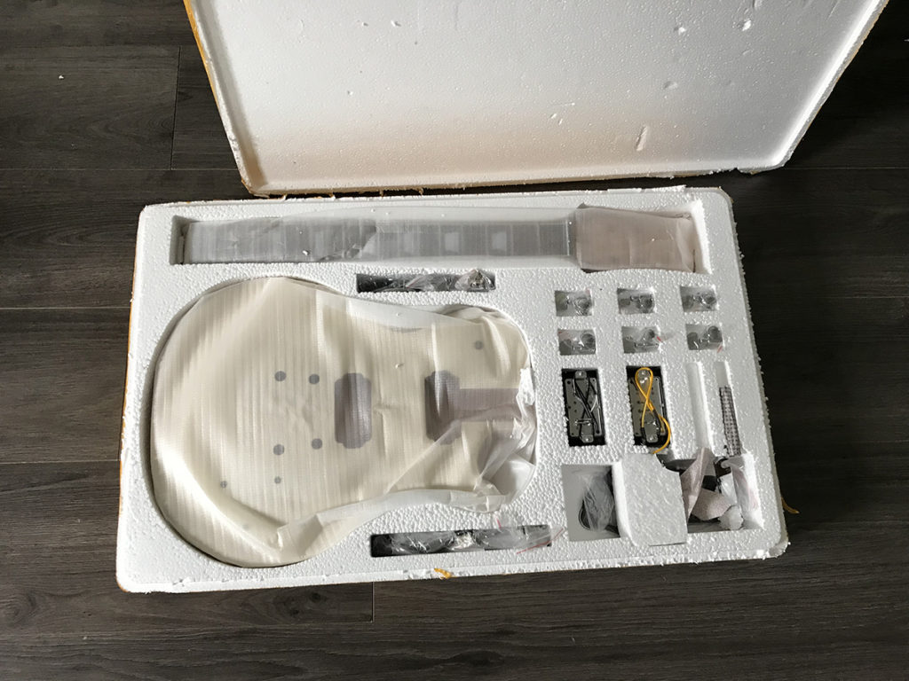

    I just received today the basic kit for the first guitar.
    Opening the box :
    [​IMG]
    [​IMG]
    Looks pretty fine, but let's have a closer look.

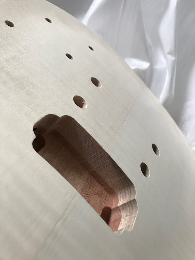

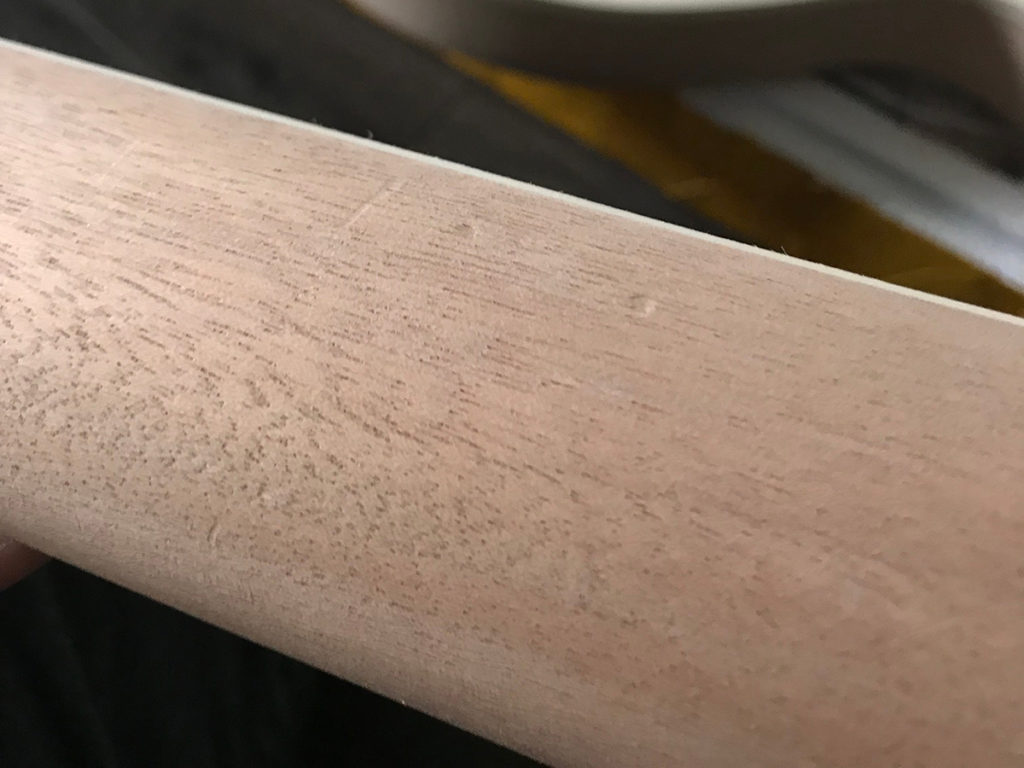

    The maple veneer looks nice and is quite regular :
    [​IMG]
    ... but it's super extra thin indeed:
    [​IMG]
    I will have to be very careful when sanding it to remove the glue residues before applying the color.

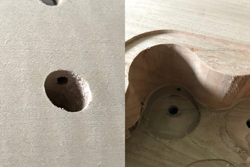

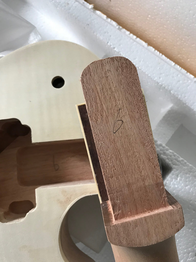

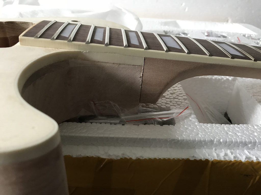

    Regarding the body/neck junction, the two pieces show the same number and fit pretty well at first sight:
    [​IMG]
    [​IMG]
    [​IMG]
    I still have to check the alignment.. and sand a bit of wood.

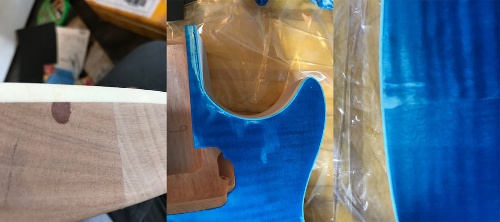

    I will also have two small dings to take care of behind the neck:
    [​IMG]

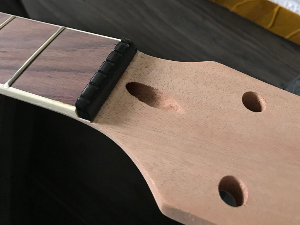

    The trussrod hole doesn't have the Gibson shape, but it will be hidden behind the veener and the nut needs to be replaced, which was already scheduled:
    [​IMG]
    The trussrod is really basic.

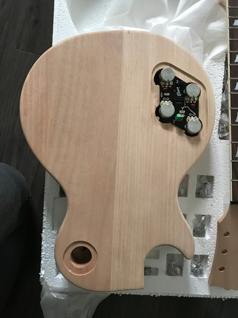

    The body is made of two mahogany pieces:
    [​IMG]
    Their colors are quite different but the fibers are pretty aligned. A dark blue color die will minimize these differences.

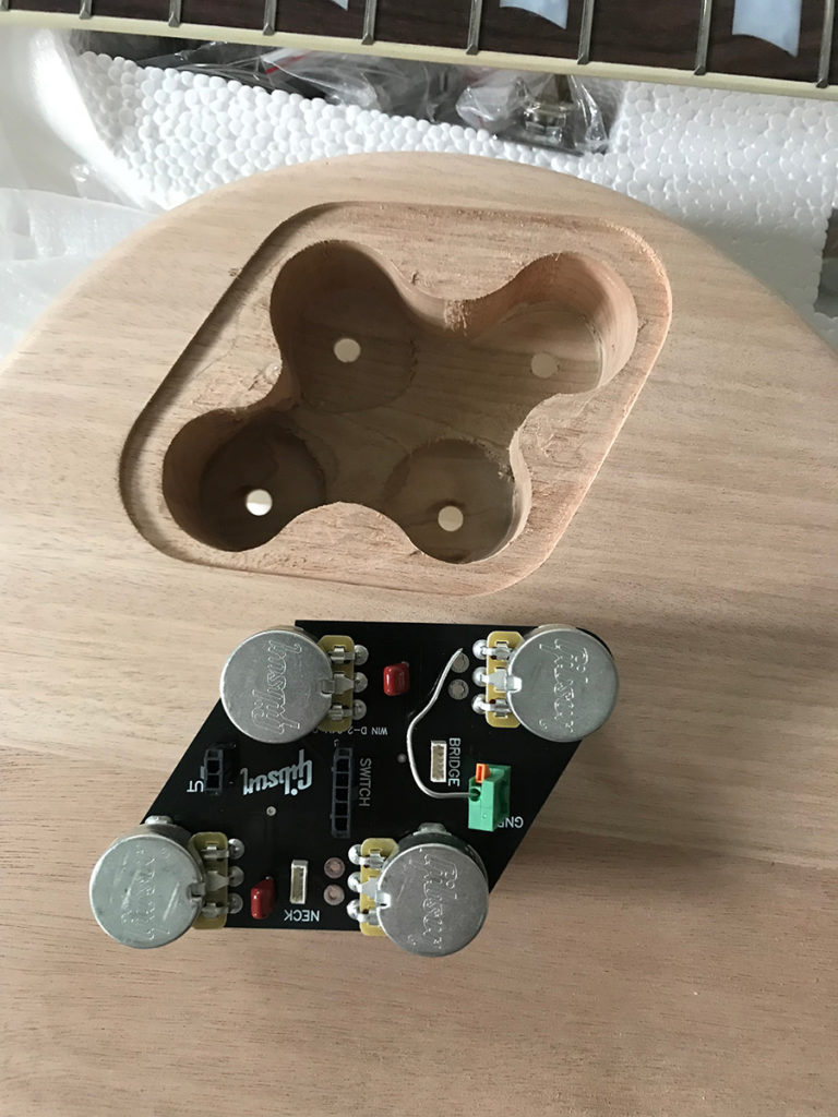

    Regarding the pots cavity, I will have to cut a bit of wood to let the Gibson Quick Connect board fit in:

    First, with the re-cut of the control cavity in order to let the Quick Connect board fit in:
    [​IMG]
    I had a heavy hand with the Dremel, and bit some wood but I am sure it will be invisible after the finish.

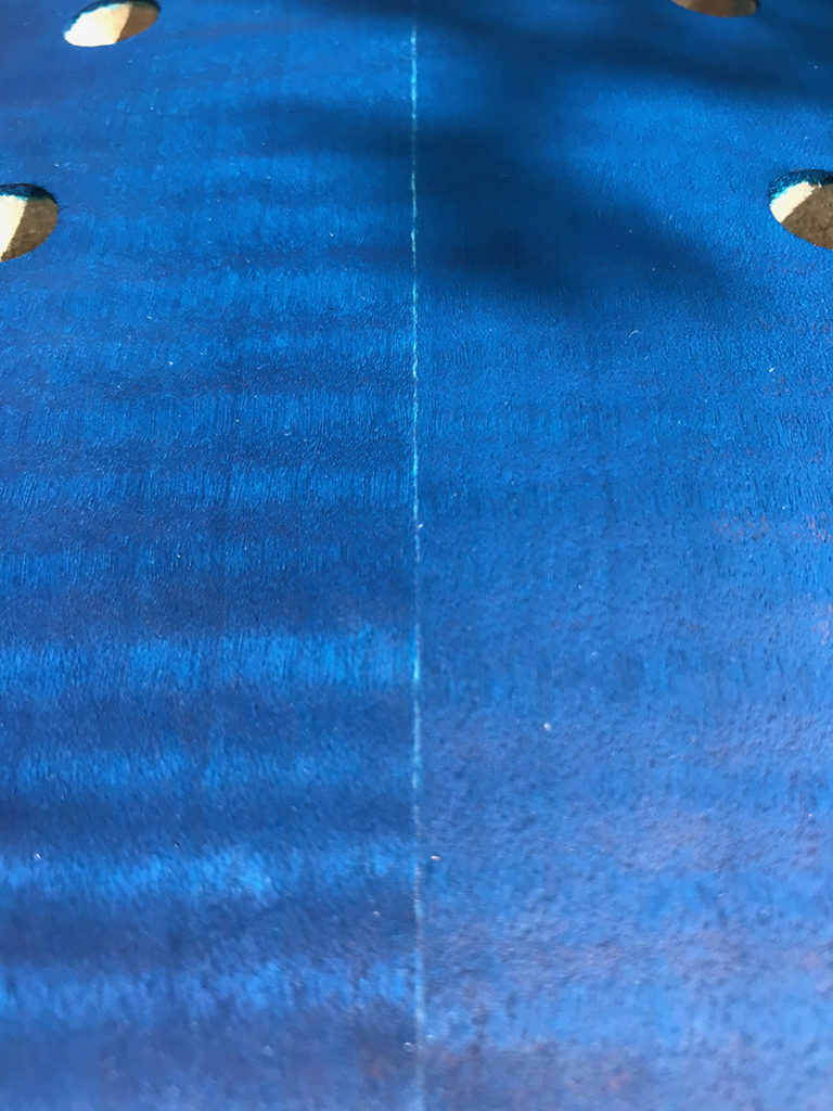

    Then, I put on the a first layer of blue dye to raise the grain and sand it with 400 grid, surprise, surprise : the body is full of glue!
    [​IMG]
    And it's even worst at the top book matched junction:
    [​IMG]
    Fortunately everything disappeared with the sanding and the veneer is still here.

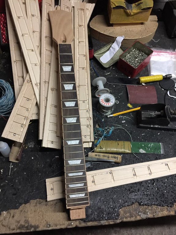

    #2 custom kit neck is done:
    [​IMG]

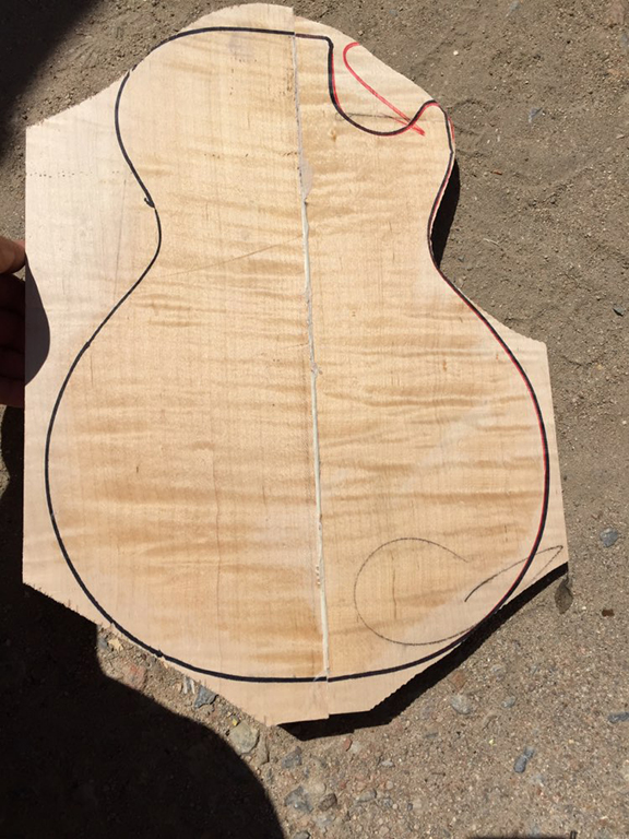

    ... and the maple top is on its way:
    [​IMG]

    First layer to set the colors in place (blue, dark blue and black):
    [​IMG]
    I took a little break and then...
    One Antique Blues Burst, one !!!!!
    [​IMG]
    Wet, the burst has a lot more colors. I am HAP-PY !
    And now, let me have a beer! :cheers2:
