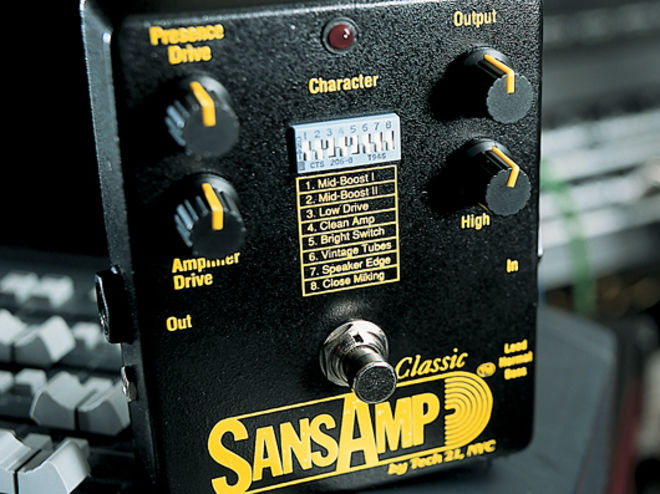

Originally Posted by theodor View Post
hello to the forum!
I am posting here because i can't find out much about this device, contacted seller without response.
I'm looking to use it so i can play without the speaker, then plug into a recording desk from its output. Some other attenuators do this not just the ones with a specific output for it, but have no idea whether this one does.
would i need a box for matching with my inputs on the desk as well (i have balanced line, mic, hiZ) or is it completely no go?
You need a DI box, something like a Sansamp
