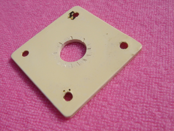

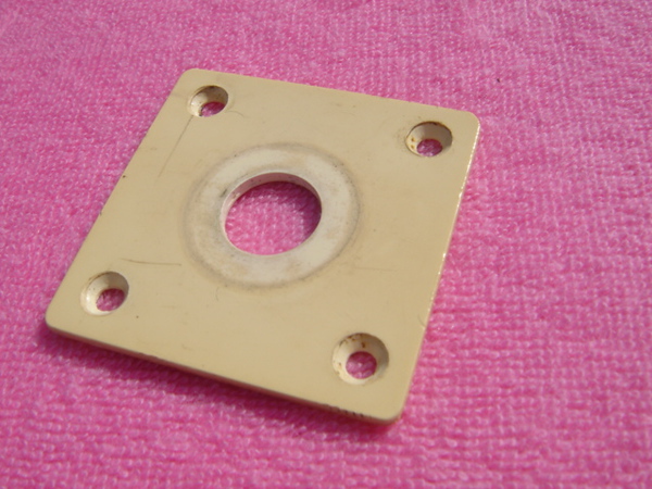

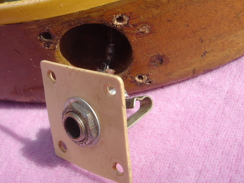

I have a question,
I'm about to drill for the jack and the jack plate on the Les Pauls I have at home are all over the place. It's supposed to be centered in the mahogany height, not in the total height or am I wrong?
LG, you're welcome, just glad bring some ideas.
Magnus Melkersson, Sweden
GooCart is online now   Reply With Quote
Old 10-13-2009, 12:15 PM   #138 (permalink)
buyusfear's Avatar
Join Date: Mar 2008
Posts: 323
Thanked 34 Times in 6 Posts
Re: GooCart's 1 Build
Here's a few pics of my R7 and R8
As you can see, even those two locations on mine, vary by a few mm's, Just as you said with yours.
I would try and centre the plate, or hole, on the mahogany, not the entire width of the guitars edge including binding.

Here are all the pictures from the original parts thread that are indeed on vintage guitars:
The Official Vintage Les Paul Parts Thread !!!

And a couple from the stock / collection of Larry Corsa:
C*V Guitars - Enter
I opened up the old Gold Top and found that it was centered in the mahogany so I put it there. I think there are enough clearance so i can position the jack plate exactly as I want it, according to the photos you posted.
I used this fancy German 22 mm drill bit. It worked great, a clean nice cut.
Magnus thanx, i've also used 22 mm for that kinda holes, also for teles too, but can you measure size of this hole on goldie?
i think it should be in "
The Thruth is online now   Reply With Quote
Old 10-14-2009, 03:32 AM   #147 (permalink)
GooCart's Avatar
Join Date: Jun 2008
Location: Umeå, Sweden
Posts: 880
Thanks: 3
Thanked 26 Times in 5 Posts
I'll check it out later tonight, I have a feeling that it's a bit bigger, maybe 24 mm.
Me and inches,,it's just to complicated with all those fractions
if i'm not mistaken isn't the jack hole 1" in size?
Of course, that makes sense. I''ll maybe try to open it up a bit with a reamer.

I got some stuff from RS GuitarWorks earlier today. It took me about 10 seconds to test mount it. I'm still waiting on the English rings and the pick guard from Retrospec, but other than that I have just about all the parts I need to complete the build.
Here are some photos.
I'm not sure about this. I think it's over aged, you can't even read the script. It looks vintage alright, but maybe a little to much. We'll see if I'll use it in the end.
Left over tuners from my R8. I've aged them with hydrochloric acid.
My plan was to mount the Tune-o-matic and the tailpiece this weekend but my man Leif is gone all weekend and I don't have the guts to do it without him supervising me so I just go around and look at it. It's not that boring after all.
