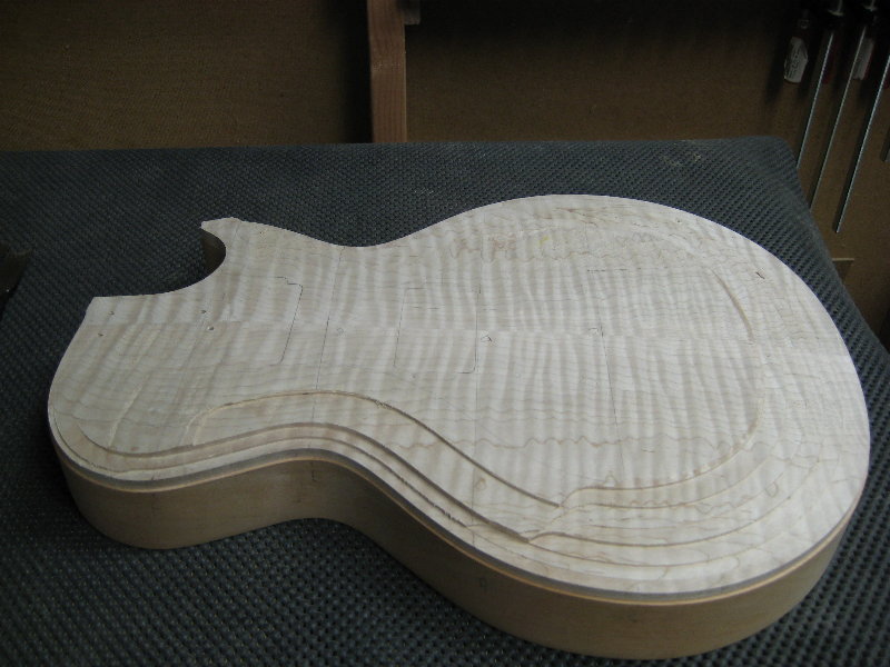

Join Date: Sep 2008
Posts: 16
Re: Just bough an Ibex plane from Stew Mac
Icegator, I did the same thing as you did. I ordered a flat 10mm ibex plane and I started carving, carving and carving...I'm up to about 6hrs of work by now. Don't really know where I'm at...I don't have a les paul to compare to, I'll probably go to the store today to check it out on a real one. But still I think I'm not doing too bad.
Dam Mr. Bones I started to see those depth marks going away. Now I should think I'm about halfway?! Any tricks on carving near the pickup areas, seems like I can't go deep enough.
Here's a link you might want to check for Ibex plane, cheaper than stewmac :
Pilgrims Projects: Luthier Supplies Fishman Transducers Seymour Duncan
Yeah, it's a lot of work! You are about halfway, maybe a little less!

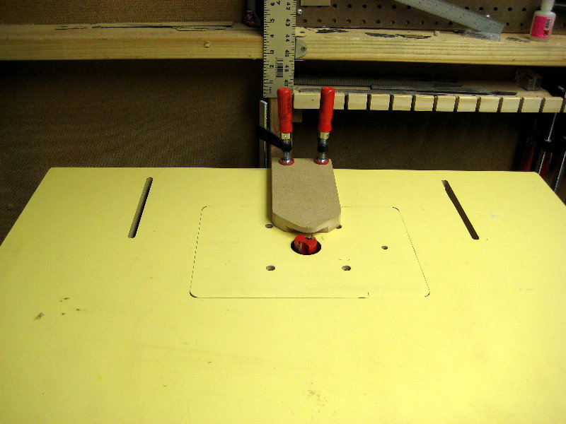

pvt
Join Date: Jul 2008
Location: Los Angeles
Posts: 39
Thanked 3 Times in 1 Post
Originally Posted by IceGator8 View Post
That's what I thought he meant. As it turns out I already have one of those.
Could you describe the technique of using one of these bowl bits?
I did this for the LP I built, but I did not use a bowl bit. A bowl bit should work even better.
You can move the wooden block back and this setup acts like a rabbetting bit to get this.
Be careful not to go too deep. I was pretty conservative with the depth of cuts I made.
I almost exclusively used the 10mm curved Ibex plane, and it did take a lot of time. I just did a rough carve for a 2nd LP using the 10 and 12mm planes, and it went much faster than the first guitar. If you have the Stewmac plans, make some photocopies if the top contour profiles, and use them to make some templates out of cardboard or maybe some 1/8" hardboard to check your carve.

The bit shown is a bowl bit. And the adjustable rabbet guide is an excellent way to use it.I have an over arm pin router(actually 2) and with a stepped template it would carve a top nicely. I will try to add a pic.http://s85.photobucket.com/albums/k6...DSC_0002-8.jpgthe bottom router is a 3.25hp Freud. I leave it in and put the guide pin in it. The router in the overarm is the good old 690.
