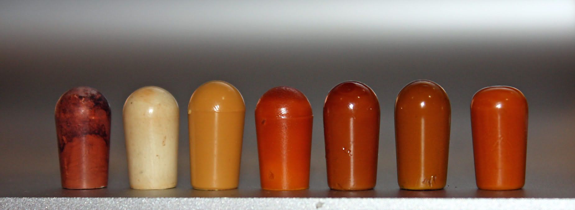

I have 2 questions as I am new to aging guitars:
1.) I read in this thread about a "razor method" to do the checking of the finish? What is it exactly.Yet I have only heard about a checking beacause of temperature changings.
2.) How did you age the toggle switch tip? I personally thought of sanding it down just a little bit and using either some brown color or coffe or shoepolish for this step. How did you do it.
Sorry for my bad English. (I am German)
Hello and thanks.
The razor or blade method is when using a sharp metal blade and trace by hand the lines that mimic the cracks from temperature change on lacquer.
And to the best way to age a switch tip is to use alcohol based wood stains, coffee and shoe polish wont make it look real at all.
Here is an example of the ones i´ve made, the white one is a LP standard and the yellow one is an aftermarket age switch, the rest are the same yellow one but aged and sanded to different shades and shapes.
If you want to do checkin lines i highly recommend you first practice with a pencil and a white page and draw them as many as you can, then use a old table or piece os wood and try the knife, after you get comfortable you can go to the guitar and have fun.

Originally Posted by nicolasrivera View Post
Hello and thanks.
Thanks for this quick answer. I think I will do the checking in the winter as I am much too to do it with razor blades. By the way: The checking also changes the sound, doesnt it!? Because it kind of 'opens' the guitar. I think it is the sam reason why guitars with very thin finish (like a Gibson SG Special Faded) sound so good (to me )
I will do the aging of the tips tomorrow with your method. Thanks
